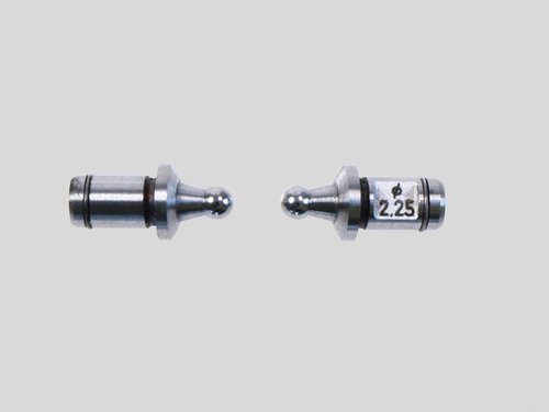

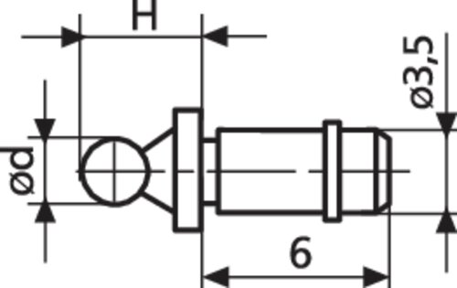

844 Tk Ball anvil 5.5 mm, carbide
Mounting shaft diameter 3.5 mm
Shaft length 6 mm
Shaft length 6 mm
165,50 €
- Especially suited for the measurement of internal or external helical gear wheels
- Use of convex contours
- Use for cone measurements
- Measuring ball made of carbide
- With cylindrical mounting shank and retainer ring which allows free rotation inside the bore of measuring arms 844 Te
- Manufacturing tolerance ball ± 2 µm
