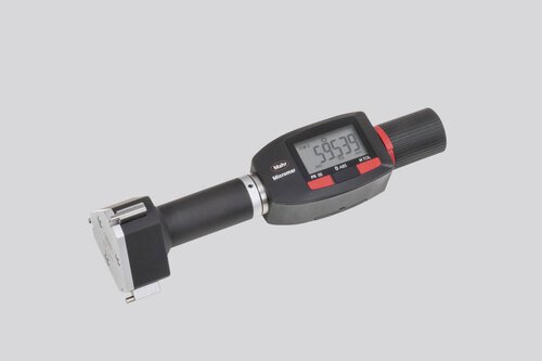

Digital 3-point inside micrometer Micromar 44 EWRi
Product number: | 4191313 |
For measuring of:
IP protection category: IP 65
DIN 863-4
Measuring range 40 - 50 mm mm
Package contains: Basic unit 44 EWRi-g, measuring head 44 Ak, instruction manual, battery, case
For measuring of:
- Through holes
- Blind holes
DIN 863-4
1.490,00 €
Functions
RESET (set display to zero), ABS (display can be set to zero without losing reference to preset), mm/inch, PRESET (dimension presetting) - 3 values possible, TOL (Tolerance and warning limit setting) - 3 tolerances possible, LOCK function (key lock), HOLD (freeze current measured value), DATA (data transmission), Bi-directional data interface (for data retrieval - transfer of parameters - remote control - individual function locks via MarCom software)
For measuring of:
- Through holes
- Blind holes
- Uniquely user-friendly with practical functions
- Optimal handling due to lightweight and compact basic unit
- Large, high-contrast numerical display with clear tolerance icons
- Self-centering measuring head consists of 3 anvils (offset 3 x 120°)
- Measuring anvils from 12 mm are carbide tipped
- From 12 mm measuring anvils for measurements up to the bottom of the bore
- From 40 mm measuring head housing made of anodized aluminium
Energy supply
Battery, battery life up to 4 years (approx 10000 hrs without wireless transmission)
Data interface
Integrated Wireless
Scope of delivery
Micromar 44 EWRi | Art. no. 4191313
b 15 mm | c 5 mm | d 76 mm |
