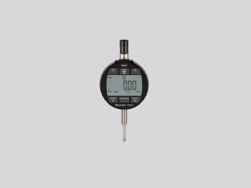

Digital indicator MarCator 1086 Ri
Product number: 4337790
IP protection category: IP 42
Factory standard
Measuring span : 12.5mm
Resolution: 0.01
Resolution inches: .0005"
458,00 €
5,60 €
Please enter the label
Functions ON/OFF, mm/inch, RESET (set display to zero), PRESET (dimension presetting) - 3 values possible, TOL (Tolerance and warning limit setting) - 3 tolerances possible, <0> (Icon mode of the tolerance display), ABS (display can be set to zero without losing reference to preset), Factor (Multiplier for measuring travel), Reversal of counting direction, Resolution selectable, LOCK function (general key lock in the menu and individual key and menu locks for process-safe measurements via MarCom software), Bi-directional data interface (for data retrieval - transfer of parameters - remote control - individual function locks via MarCom software), Remote-controllable by MarCom software, DATA (data transmission), HOLD (freeze current measured value)
Application Comprehensive measuring function for static measurements such as lengths, distances and length differences
  • Tempered glass front with touch control panels with enormous advantages:
    - improved safety of measurement values in measuring stands, as only a light touch of the key - no keystroke - is required, thus no adjustment or deformation of the measuring device
  • Clear tolerance symbols and colored LED signals (red, green, yellow) for measured value classification
    - without warning limit input selectable: NoGo/Go or NoGo/Go/Rework
  • LED signals (red, green, yellow) in mode:
    - powered by data cable DK-U1: permanent
  • High contrast LCD display, thus very clear and safe to read
  • Operating and display unit (bezel) can be rotated through 280°
  • Mounting shank and measuring spindle are both made of hardened stainless steel
Scope of delivery battery, test certificate, instruction manual, carton
MarCator 1086 Ri | Art. no. 4337790
