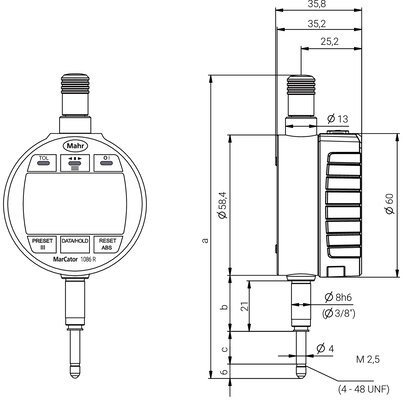

ON/OFF, mm/inch, RESET (set display to zero), PRESET (dimension presetting) - 3 values possible, TOL (Tolerance and warning limit setting) - 3 tolerances possible, <0> (Icon mode of the tolerance display), ABS (display can be set to zero without losing reference to preset), Factor (Multiplier for measuring travel), Reversal of counting direction, Resolution selectable, LOCK function (general key lock in the menu and individual key and menu locks for process-safe measurements via MarCom software), Bi-directional data interface (for data retrieval - transfer of parameters - remote control - individual function locks via MarCom software), Remote-controllable by MarCom software, DATA (data transmission), HOLD (freeze current measured value)
Comprehensive measuring function for static measurements such as lengths, distances and length differences
- improved safety of measurement values in measuring stands, as only a light touch of the key - no keystroke - is required, thus no adjustment or deformation of the measuring device - Clear tolerance symbols and colored LED signals (red, green, yellow) for measured value classification

a 151.8 mm | b 23.3 mm | c 26.5 mm |
