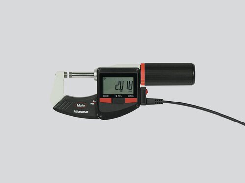

Digital Micrometer Micromar 40 EWR-L
Product number: 4157022
  • Avoiding workpiece damage: The non-rotating spindle has a touching touch, which prevents scratch marks on sensitive and finely machined surfaces
  • Ideal for measuring thin metal foils without twisting and bending them
  • Thread flank measurement by using thread wires: Both wire holders always remain in the engaged position with the non-rotating spindle
IP protection category: IP 65
Data interface: MarConnect (bidirectional), USB, Digimatic
ISO 3611
Measuring range 50 - 75 mm mm
Package contains: setting standard (measuring range of 25-50 mm), battery, test certificate, instruction manual, case
609,00 €
Variants
5,60 €
Please enter the label
Functions RESET (set display to zero), ABS (display can be set to zero without losing reference to ORIGIN), mm/inch, ORIGIN (for entering a numerical value), LOCK function (key lock), TOL (Tolerance and Warning Limits Input), HOLD (freeze current measured value), DATA (data transmission via connection cable), Bi-directional data interface (for data retrieval - transfer of parameters - remote control - individual function locks via MarCom software)
  • High contrast digit display
  • Stainless spindle is hardened throughout and ground
  • Spindle and anvil are carbide-tipped
  • QUICK DRIVE
  • Sliding spindle
  • Ratchet is integrated in the thimble
  • Lacquered steel frame, heat insulated
Material Contact surface carbide
Data interface MarConnect (bidirectional), USB, Digimatic
Energy supply Battery life approx. 2 years
Package contains setting standard (measuring range of 25-50 mm), battery, test certificate, instruction manual, case
