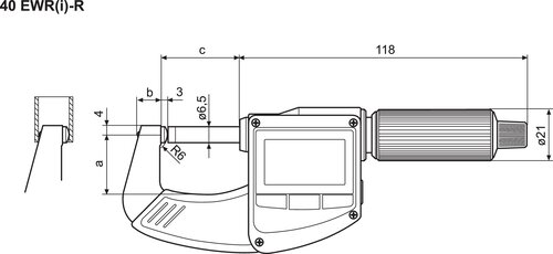

For measuring the thickness of pipe walls

Functions RESET (set display to zero), ABS (display can be set to zero without losing reference to ORIGIN), mm/inch, ORIGIN (for entering a numerical value), LOCK function (key lock), TOL (Tolerance and Warning Limits Input), HOLD (freeze current measured value), DATA (data transmission), Bi-directional data interface (for data retrieval - transfer of parameters - remote control - individual function locks via MarCom software)
Application For measuring the thickness of pipe walls
  • Measuring surfaces: spherical anvil, planar spindle
  • High contrast digit display
  • Stainless spindle is hardened throughout and ground
  • Spindle and anvil are carbide-tipped
  • Rapid drive
  • Ratchet is integrated in the thimble
  • Lacquered steel frame, heat insulated
Energy supply Battery life approx. 2 years
Data interface Integrated Wireless
Material Contact surface carbide
