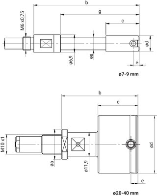

- For rapid testing of diameter, roundness and conicity of bores
- Especially suitable for testing batches with tight tolerance zones
- Rocking in the bore is not required to determine diameter
- Ideal for use in conjunction with digital display units and for subsequent processing of measured values
- Measuring probe made of hardened, stainless guide cylinder and diamond-tipped probes
- Carbide driving needle transfers radial measuring movement to the display unit
- Constant measuring force thanks to inbuilt measuring force spring. Measuring results are therefore independent of personal sense of touch
- Measuring head, measuring instrument holder, depth extensions, right-angle attachments and depth stops form a comprehensive modular system
Material Contact surface
diamond
Marameter 844 D-D | Art. no. 4484306DKS
a 15 mm | b 38.2 mm | c 20 mm | e 3.5 mm |
