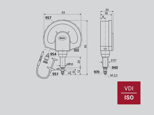

Dial comparator Millimess 1003 ZT
Factory standard
IP 54
Measuring range : ± .0020"
Graduation value inch: .00005"
Package contains: adapter bush 940, 8 mm to 3/8", test certificate, case
Factory standard
IP 54
288,80 €
- Large, high contrast dial face
- Lockable fine adjustment screw
- Shockproof movement
- Measuring spindle is mounted in a high precision ball guide for minimal hysteresis
- Resistant to lateral forces (side play) acting on the measuring spindle
- Maximum sensitivity and accuracy are ensured by the jeweled movement in conjunction with the precision gears and pinions
- Box type protective housing
- Constant measuring force
- Measuring spindle can be retracted with either a screw in cable release or with a lifting knob
