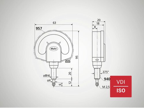

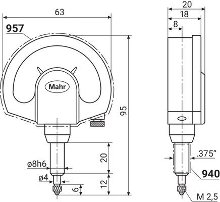

Mechanical dial comparator Millimess 1010 T
Product number: 4332005KAL
Dial comparator Millimess 1010 T
Factory standard
IP 54
Measuring range : ± 0.25 mm
Readings: 0.01
Package contains: test certificate, case
228,30 €
Variants
Add service
Test interval
Place of use
Please enter the place of use
5,60 €
Please enter the label
  • Large, high contrast dial face
  • Adjustable tolerance markers
  • Lockable fine adjustment screw
  • Shockproof movement
  • Mounting shank and measuring spindle are both made of hardened stainless steel
  • Measuring spindle is mounted in a high precision ball guide for minimal hysteresis
  • Resistant to lateral forces (side play) acting on the measuring spindle
  • Maximum sensitivity and accuracy are ensured by the jeweled movement in conjunction with the precision gears and pinions
  • Box type protective housing
  • Constant measuring force
  • Measuring spindle can be retracted with either a screw in cable release or with a lifting knob
Package contains test certificate, case
