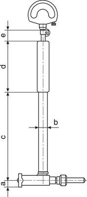

Marameter 844 N | Art. no. 4474003
a 16 mm | b 24 mm | c 366 mm | d 110 mm | e 28 mm |
